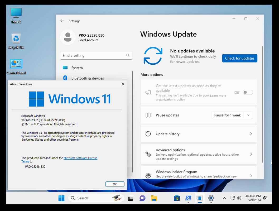

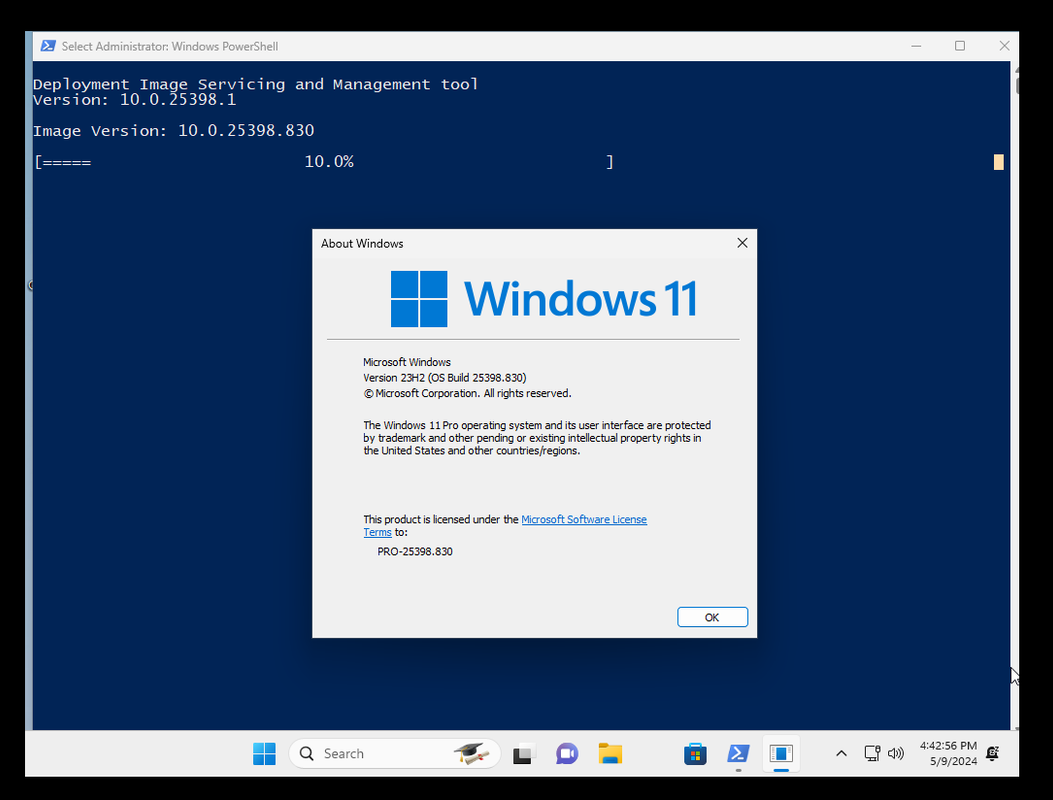

@d3smond I have rebuilt it for you, this version can be updated
Deployment Image Servicing and Management tool
Version: 10.0.25398.1
Image Version: 10.0.25398.1
Processing 1 of 2 - Adding package Package_for_ServicingStack_830~31bf3856ad364e35~amd64~~25398.830.1.3
[==========================100.0%==========================]
The changes due to package Package_for_ServicingStack_830 requires the current servicing session to be reloaded.
All the packages will be processed again.
Processing 2 of 2 - Adding package Package_for_RollupFix~31bf3856ad364e35~amd64~~25398.830.1.10
Processing 1 of 1 - Adding package C:\Users\HaiPro\Desktop\UpdateOS\lcu\windows11.0-kb5036617-x64-ndp481.msu
25398.830_Pro_for_Workstation_[20240510_094942].iso
download link
https://drive.google.com/file/d/1vYV8fMnWnfelrZOKDj4hNupa84OxbfxQ/view?usp=sharing
Modified: Friday, May 10, 2024, 9:50:11 AM
MD5: C5C61EF22016E51FF6091F6E76562B47
SHA1: 6AB94ECBC26E64F1E9DE091BA33090CE4B2288D1
CRC32: 0E2368A3

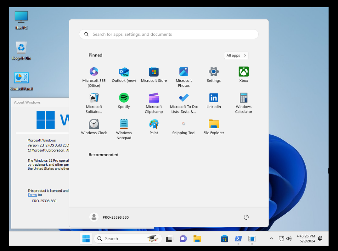

I have tested your version and it works good so I will stay on it.
There is just a weird issue, device manager shows a Unknown device with a warning sign and when I check I see that it is the Intel Bluetooth but under Bluetooth the Intel driver seems to have installed and is being used. I have noticed that this happens 25398 one some versions but not others. If I disable Bluetooth the Unknown device is gone, so I will keep it disabled for now.
Can your version install unmodified updates or will it require custom updates? I am not sure if Pro WS can install unmodified updates or just Pro.

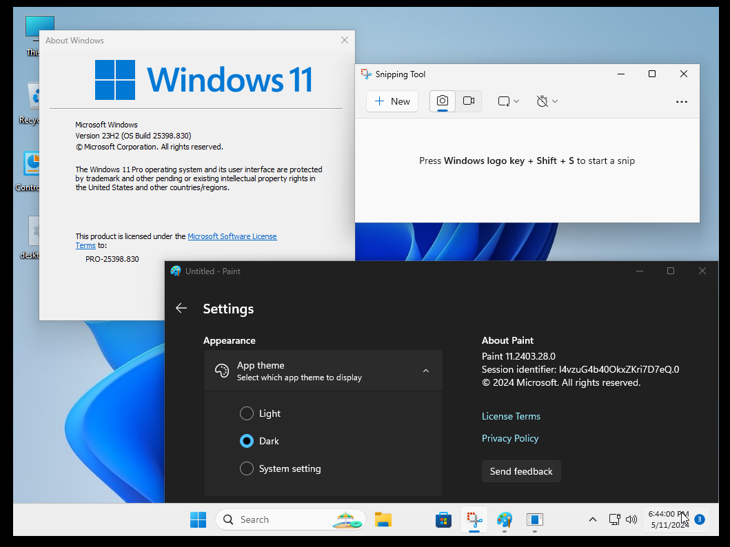

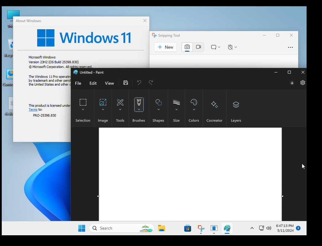

I also tried the WIM by Hoang Duch2 and it works well too except that snipping tool and paint shows error when I launch them from start menu.
Thanks once again :)

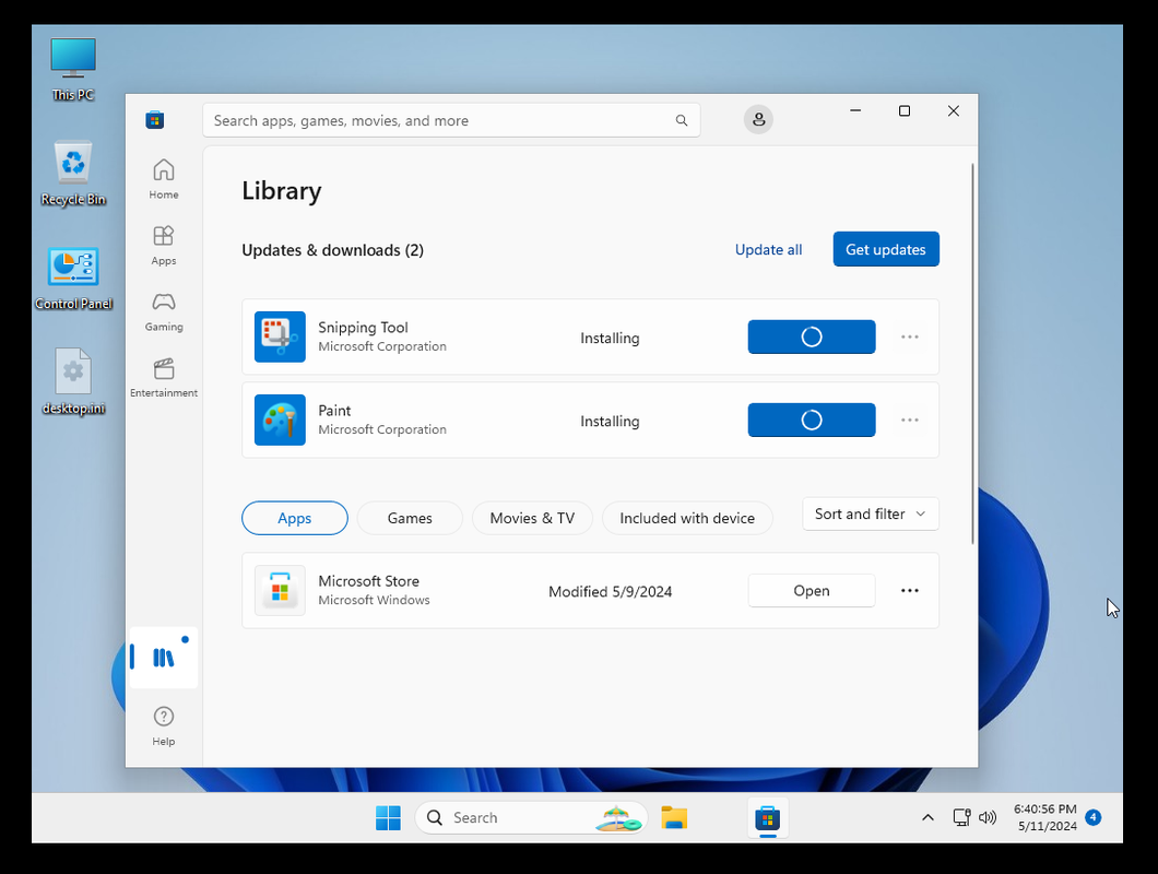

You should update from Store for Paint and Snipping Tool:

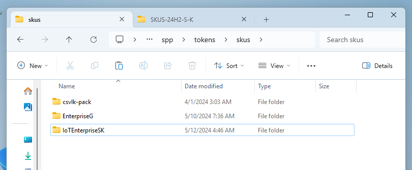

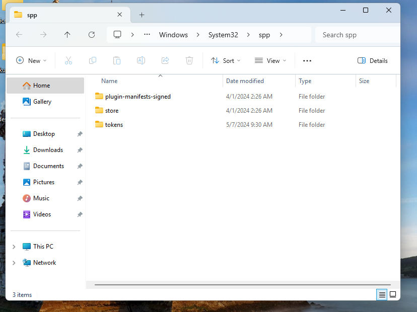

Bạn @bacsilam , ở cmt bên trên @2012mshs hướng dẫn theo cách PRO, còn tôi hướng dẫn theo cách bình dân học vụ, tôi cũng làm cho bản SK, tuỳ ý thích của bạn, bạn load về 2 files tôi gửi, Skus và Mas rồi thực hành theo hình ảnh nhé:

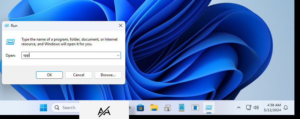

Thử mở folder spp, tìm tới tokens\skus:
Tại đây chỉ có ENT-G:

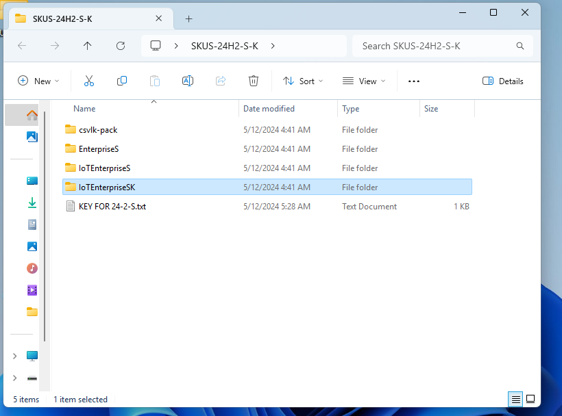

Chi tiết folder Skus tôi upload như sau:
Chép folder IoTEnterpriseSK vào như hình dưới:

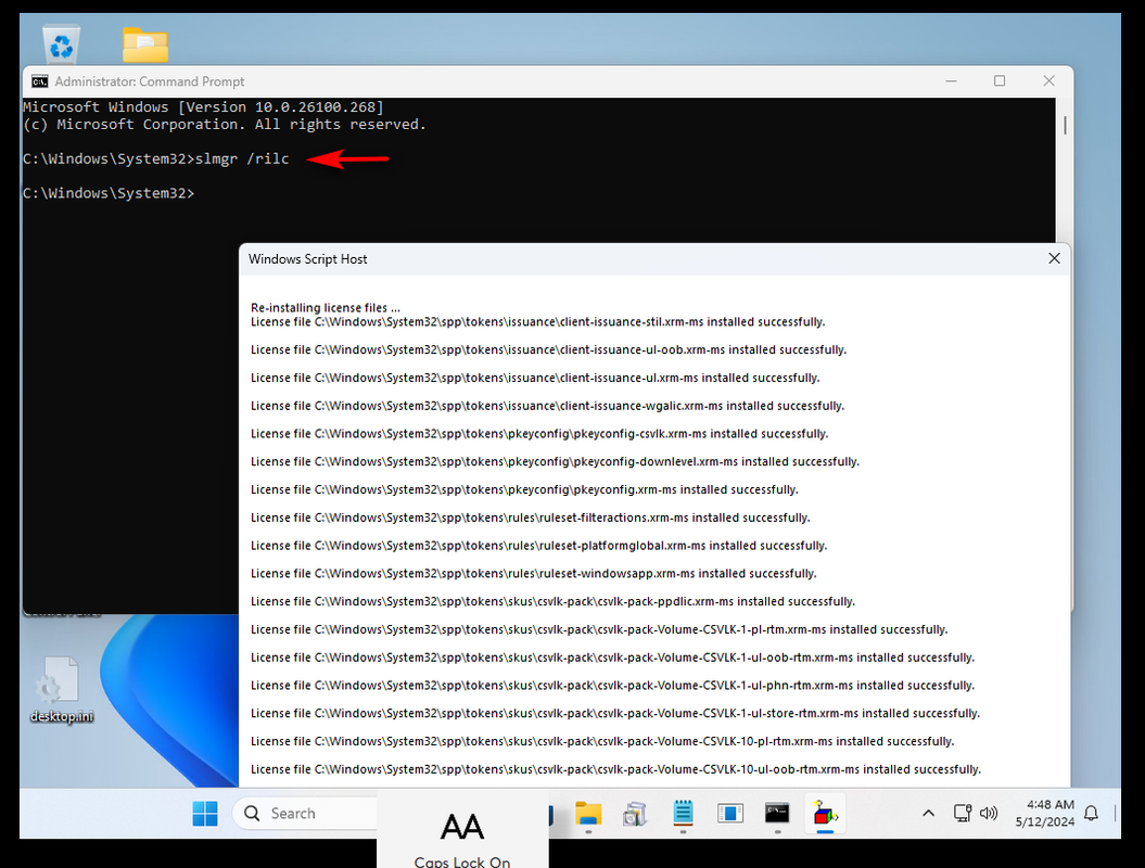

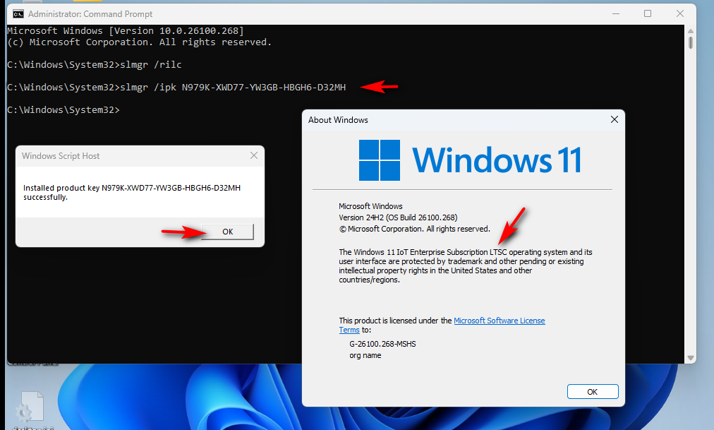

Mở cmd, runas admin, chạy lệnh bên dưới và đợi cho nó hiện lên Windows Script host:
slmgr /rilc
Tắt window host đó đi và chạy tiếp lệnh điền key:
slmgr /ipk N979K-XWD77-YW3GB-HBGH6-D32MH

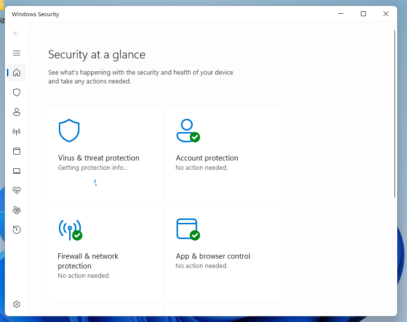

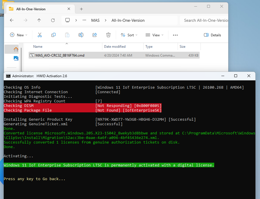

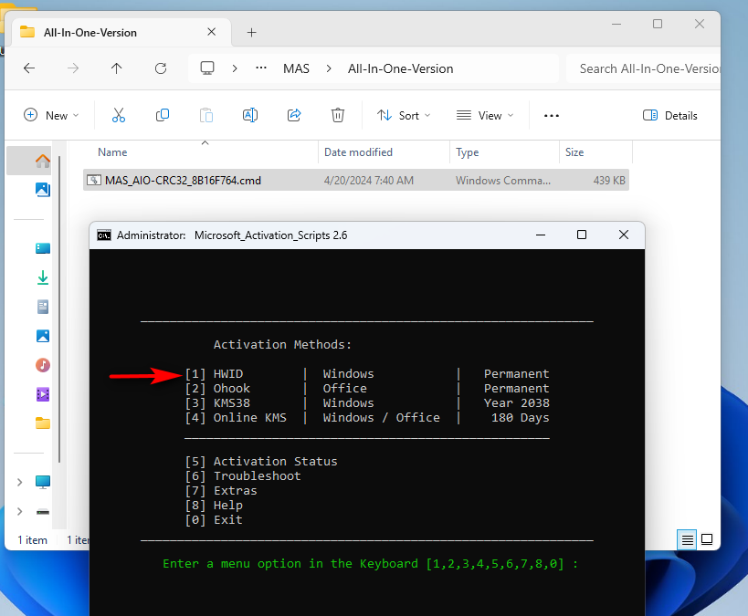

Tắt hết các windows trên và mở MAS 2.6 như hình:
Nhấn 1 bên trên và enter, kết quả như sau:
Bản này mục Activation đã bị xoá nên tôi check lại Activation với lệnh sau:

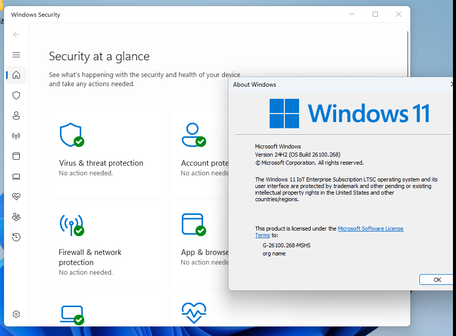

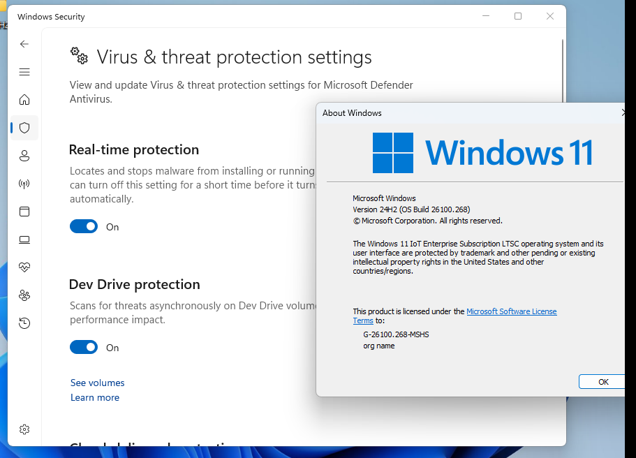

Restart máy 2, 3 lần để có lại WD như hình:
slmgr /rilc
