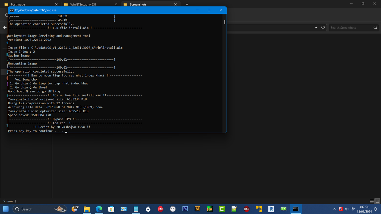

Và đây là hình ảnh:
Em rảnh được tý, tranh thủ chạy lại, em gửi lên quá trình up, file Wim thành quả cho Bác xem ạ!
(Em up bằng tool của bác @2012mshs có thư mục sv_moment, không tự động)

Processing 1 of 2 - Adding package Package_for_ServicingStack_2567~31bf3856ad364e35~amd64~~22621.2567.1.1
[==========================100.0%==========================]
Processing 2 of 2 - Adding package Package_for_RollupFix~31bf3856ad364e35~amd64~~22621.3007.1.8
Deployment Image Servicing and Management tool
Version: 10.0.22621.2792
Image Version: 10.0.22621.3007
Processing 1 of 1 - Adding package Package_for_KB5027397~31bf3856ad364e35~amd64~~22621.2355.1.1
----------------------!! Hoan thanh cap nhat !!----------------------------
----------------------!! Kiem tra cap nhat cu !!---------------------------
----------------------!! Bat dau don dep WinSxS !!-------------------------
Image Version: 10.0.22631.3007
[=====                      10.0%                          ]
----------------------!! Luu file install.wim !!---------------------------
Image File : C:\UpdateOS_VI_22621.1_22631.3007_S\wim\install.wim
Image Index : 1
Saving image
Unmounting image
----------!! Ban co muon tiep tuc cap nhat index khac? !!------------------
    Vui long chon
 1. Go phim C de tiep tuc cap nhat index khac
 2. Go phim Q de thoat
Go C hoac Q sau do go ENTER:c
-------------------------------------!! LUU Y !!---------------------------
------------------!! Qua trinh cap nhat Windows mat vai phut !!------------
-------!! An phim bat ky de tiep tuc (Hoac dong cua so de huy bo) !!-------
Press any key to continue . . .
----------------------!! Tao thu muc giai nen !!---------------------------
A subdirectory or file mount already exists.
A subdirectory or file tmp already exists.
----------------------!! Lay danh sach index trong install.wim !!----------
Details for image : wim\install.wim
Index : 1
Name : Windows 11 Enterprise LTSC 22H2
Description : Windows 11 Enterprise LTSC 22H2
Index : 2
Name : Windows 11 IoT Enterprise LTSC 22H2
Description : Windows 11 IoT Enterprise LTSC 22H2
----------------------!! Chon index de cap nhat !!-------------------------
Chon index de cap nhat (Vi du: 1)2
----------------------!! Lien ket install.wim !!---------------------------
Mounting image
----------------------!! Tien hanh cap nhat !!-----------------------------
Image Version: 10.0.22621.1
The changes due to package Package_for_ServicingStack_2567 requires the current servicing session to be reloaded.
All the packages will be processed again.
[=====                      10.0%                          ]
[========================== 45.1%                          ]
Image Index : 2
Saving image
Unmounting image
    Vui long chon
Go C hoac Q sau do go ENTER:q
----------------------!! Toi uu hoa file install.wim !!--------------------
"wim\install.wim" original size: 6183234 KiB
Using LZX compression with 12 threads
Archiving file data: 9017 MiB of 9017 MiB (100%) done
"wim\install.wim" optimized size: 4595230 KiB
Space saved: 1588004 KiB
----------------------!! Bypass TPM !!-------------------------------------
----------------------!! Xoa rac !!----------------------------------------
--------------!! Script by [email protected] !!-----------------------------

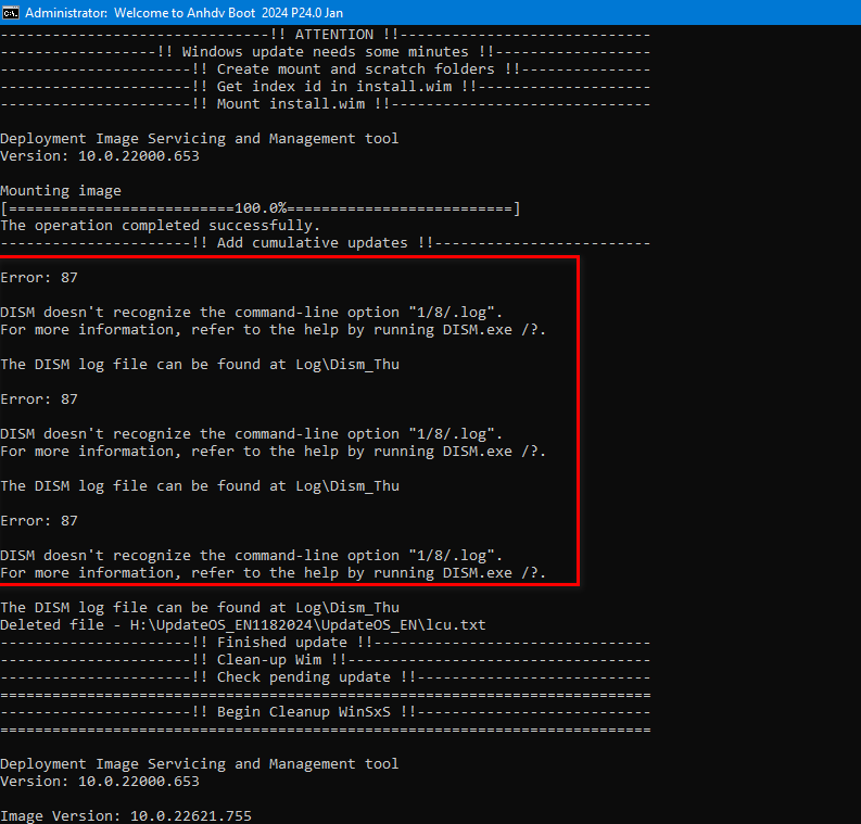

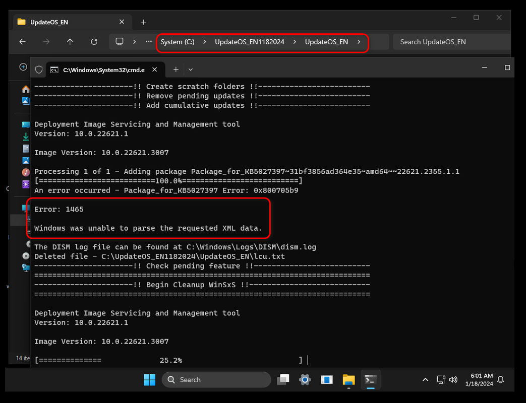

Bạn ơi................... tôi chuẩn bị đầy đủ nguyên liêu và chạy tool này thì bị lỗi như sau:

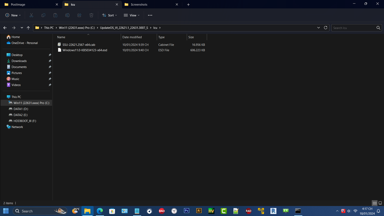

Thấy nhiều bạn vẫn chưa làm được tôi làm lại từ đầu (up 22621.755 >>> 22631.3078) bằng tool mới với nguyên liệu tôi đã post từ trước (#11203)

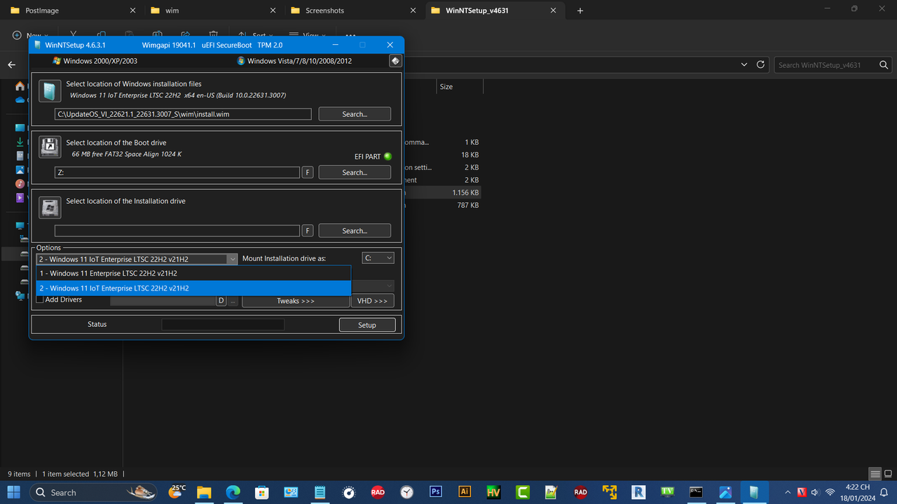

Thấy chạy có vẻ nhanh và không chiếm nhiều tài nguyên của máy. Theo hình thì tool đã nhận file "windows11.0-kb5027397-x64_full.cab" và ra 22631.xx rồi.

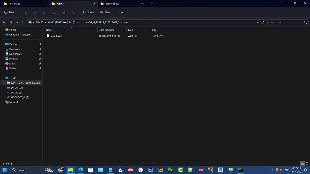

Đã xong trong thời gian hơn 46 phút, tuy nhiên dung lượng file quá lớn (hơn cả bất ngờ)
Thấy nhiều bạn vẫn chưa làm được tôi làm lại từ đầu bằng tool mới với nguyên liệu tôi đã post từ trước (#11203)
